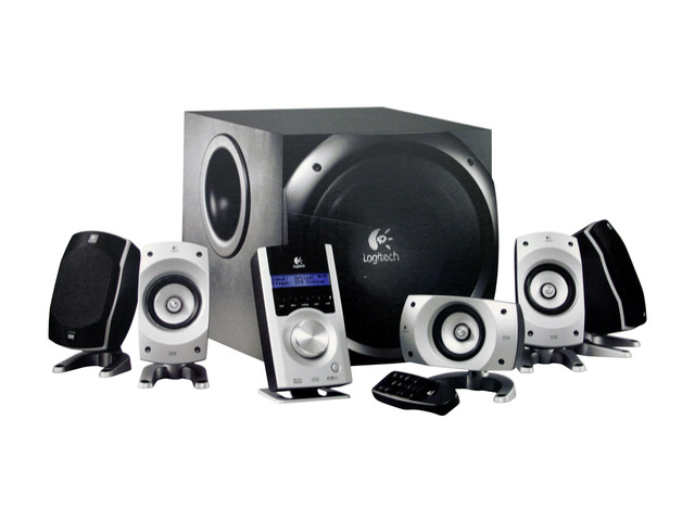

    If you want to connect your DVD player to your computer speakers, what you need is a Digital decoder.
    You can do this three ways (maybe more, but the alternatives escape me right now):
    1. Get a receiver so you can integrate your pc and your dvd to feed audio signals to your receiver and then out to your pc speakers. The only problem here is that the speakers need to be connected to the receiver and I dont know of any PC-exclusive speakers that utilize an external amp (i.e. the receiver's amp) for power. Usually PC speakers use their own proprietary amp which is usually located in the sub. You may need to go with a HTiB (home theater in a box) speaker setup for this one or buy speakers separately (bookshelves or floorstanders from a speaker company's line, i.e. Klipsch synergy).
    2. The easier way to do this is to get a speaker with a decoder included. This would include the Logitech Z680 and the Logitech Z5500 among a few. All you would do is hook up your PC to the control module of the speaker setup and also hook up your DVD's digital cable (coax or optical) to it as well.... and voila - you're done!
    3. Easiest way is just to purchase a stand-alone digital decoder like the one Creative has... DDTS100. You should be able to connect ANY pc speaker and hook up multiple audio inputs into it and have it converge onto a single pc speaker set.
    Here are links to a few PC speakers with a digital decoder included:
    z680
    http://cgi.ebay.com/Logitech-Z-680-Z...QQcmdZViewItem
    z5500
    http://www.newegg.com/Product/Produc...82E16836121120
    Creative Decoder (you can use this to hook up ANY PC speaker system and allow audio input from either a DVD player or your PC):
    http://cgi.ebay.com/NEW-Creative-Lab...QQcmdZViewItem
    If I'm off in my suggestions, just let me know.

    hey, thanks for all the replies! They've been a big help.
    I like the way the Z680 speakers look, that's probably around his price range.
    Being that he wants a NEW speaker system (he's got a 2.1 right now), those would work good.
    But that decoder is pretty much exactly what I had in mind too. That would work nicely depending on what route he wants to go with his speaker choice.
    He doesn't really want to purchase a receiver, so I'd have to go with either of these.

    The 680s at ebay prices are a STEAL! They used to run about $350-400 about a year and a half ago just FYI.
